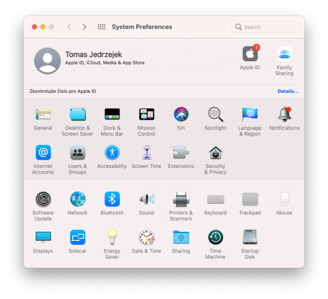

4. Open System Preferences of the Mac and click at Security & Privacy.

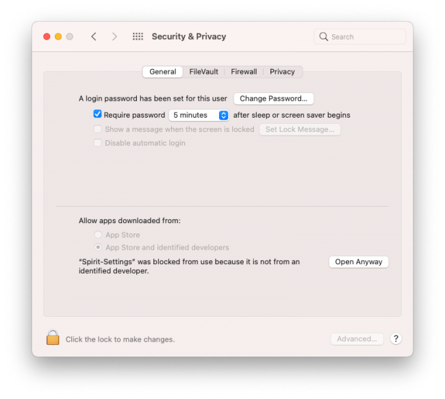

5. In General tab click at the Open Anyway button.
6. Then window will appear which must be confirmed by Open button. Then the Spirit Settings will finally start.
