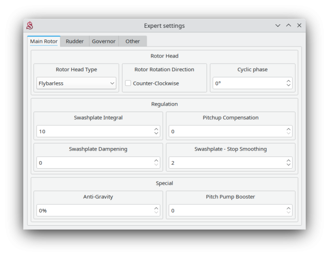

There is parameter Stabi/Rescue Algorithm in the Advanced - Expert Settings. It can greatly improve reliability and precision of the Stabilisation and Rescue modes. Following options are available:
  • Standard
  • High Precision
  • High Immunity
Both can be found in Advanced - Expert Settings.
Generally default settings (Standard) should be suitable for the most models. If you are in doubt, please use this settings.
If you are unable to achieve precise behavior with basic maneuvers, enable High Immunity option. This mode is suitable for models that are producing high vibrations or a kind that is strongly interfering with sensors.
For advanced pilots that are performing complicated maneuvers parameter High Precision' option can be helpful. Use this parameter only if default settings are not satisfying and model is in a good condition. Otherwise results can be worsened.
