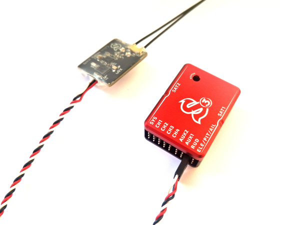

Spirit 3 and Spirit GT units require only a direct cable between RUD port and port 2 '''X''' of the Wave receiver. | Spirit 3 and Spirit GT units require only a direct cable between RUD port and port 2 '''X''' of the Wave receiver. | ||
| − | [[File:spiritrx-wiring-gt.jpg|600px]] | + | [[File:spiritrx-wiring-gt.jpg|600px]] [[File:spiriturx-wiring-3.jpg|600px]] |

Spirit 3 and Spirit GT units require only a direct cable between RUD port and port 2 X of the Wave receiver.
