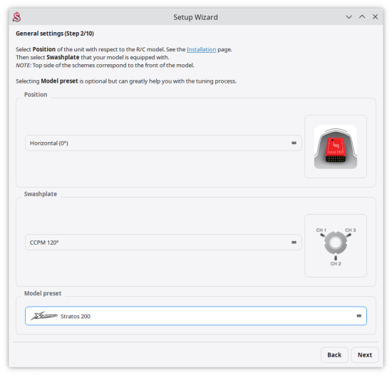

| − | ==Setup Wizard== | + | ===Setup Wizard=== |
After flashing you can start the '''Setup Wizard''' that include all required settings. | After flashing you can start the '''Setup Wizard''' that include all required settings. | ||
| + | Go through the wizard, select your Receiver type and then select '''STRATOS 200 preset'''. This is the most important step. | ||
[[File:StratosWizard.png|550px]] | [[File:StratosWizard.png|550px]] | ||
| + | ===Tuning=== | ||

2.1 Setup Wizard
After flashing you can start the Setup Wizard that include all required settings. Go through the wizard, select your Receiver type and then select STRATOS 200 preset. This is the most important step.
2.2 Tuning
IMPORTANT: It is required to adjust Swashplate Subtrims in the Setup Wizard to obtain levelled swashplate. This mean to move with CH1, CH2 and CH3 Subtrims in the PC software until all 3 servos are in the center as precise as possible. After going through the process you are almost Ready to Fly.
