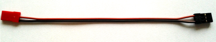

To allow the integration you have to connect additional cable to your current setup. This cable will connect the Telemetry port of the receiver with the SYS port of the unit. So there should be two connections between unit and receiver for:
  • Channel transmission (PWM, PPM or SUMD)
  • Telemetry and Integration data
Use the Hott Integration cable available in our eshop. Connect it according the following steps:
  1. End with black servo connector should be connected to the receiver on the Telemetry port marked with T label.
  2. End with red servo connector should be connected to the SYS port.
Warning.png It is very important to pay attention during the connection!
If connected wrongly, it will damage the unit permanently. The cable end where red wire is in the middle pin must be always connected to the unit. Never use other cables for this connection!
Info.png Servo connector in the Graupner Hott receivers is connected so that the signal wire is at the bottom.
