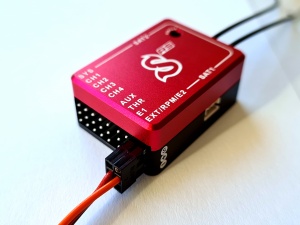

Wire layout
Orange wire: RPM Output Signal
Red wire: Ground
Brown wire: 3.3V - 15V
Wiring Example
