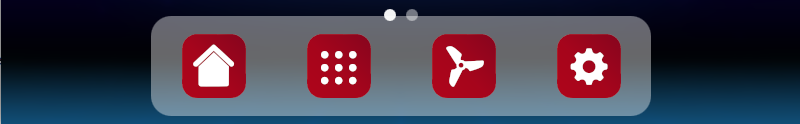

1.2 Main Panel
Bottom Panel has 4 different Icons (listed from the left side):
  • Home
  • Applications
  • Model
  • Configuration

1.3.3 Pages
Some menus have several Pages available. This can be distinguished by a small dots at the Main Panel. You can move between the pages by using so called Swipe Gesture (touching the Screen and moving your finger to left or right side).
