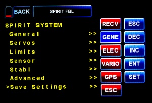

To enter the Menu you have to enter Function (F)/Telemetry/Setting & Data View. The unit is emulating General Air Module sensor. So in the Menu you have to see, that the GAM (General) is active. Then you have to press the GAM (General) button (MZ series) to switch to this sensor type - transmitter will start to listen responses from the Spirit unit. If you are using HoTT MX series transmitter, you have to change sensor type with the arrows on the left side to General.
Then use the ENT button (MZ series) or right arrow on the right side (MX series) to reach the SPIRIT SYSTEM page.
Graupner MZ-18 display
Graupner MX-20 display
