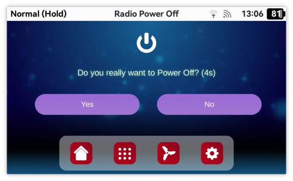

  1. Short press at the "S" button,
  2. Confirm the intention by pressing YES at the Display.
Info.png You have to confirm Powering Off within 5 seconds.
