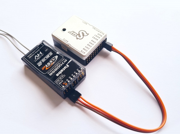

2.2 Spirit GT
Spirit GT does not require FrSky integration cable at all. It is enough to use a stright servo cable. Connect S.BUS2 port with RUD port at the Spirit GT.
