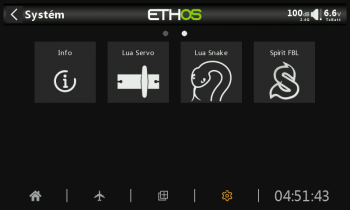

Extract downloaded ZIP file and copy whole directory "spirit" to "scripts" to SD Card of your radio. Then (re)power the radio and from then you will see Spirit icon in the Settings menu.
3 Usage

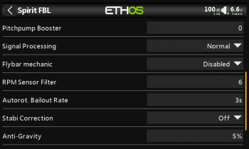

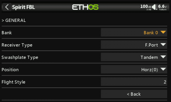

You can start the Spirit integration at any moment from second page of the Configuration menu.
The integration scripts should work with all EthOS radios. With F.Port and F.BUS connection integration will work faster and is highly recommended.

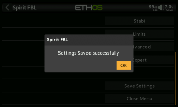

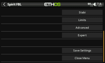

Do not forget to save any changes in the settings by clicking Save Settings in the integration menu.

3.1 Closing the menu
Please make sure to exit the integration with Close Menu before flying - Status LED should be steady On before a flight.
