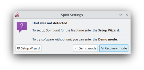

  2. Start the software. Select Recovery mode when prompted.

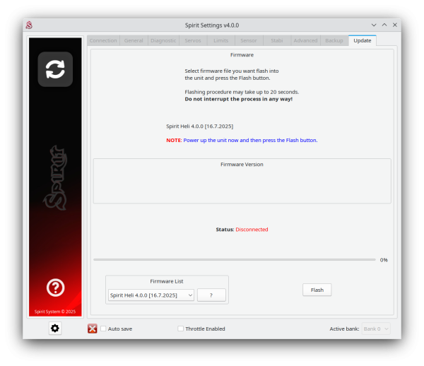

  3. Choose correct COM port in the Connection tab first.
  4. Go to the Update tab and select firmware you want to flash.
  5. Power up the unit (from your BEC or a battery) and wait until Status LED start to pulsating.
  6. Press the Flash button and confirm - software will download firmware from Spirit Server and flashing should start immediately.
  7. In 10 seconds, unit should be operating again without any issue. Your settings are untouched.
