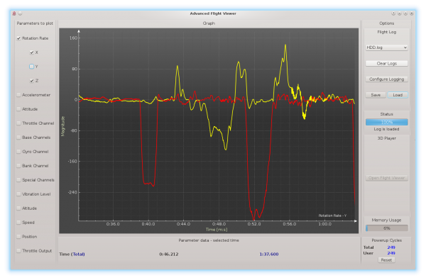

Example 1: Rotation Rate - [Degrees Per Second] - X (Elevator axis), Z (Rudder axis)

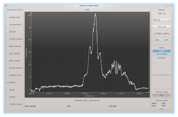

Example 2: Altitude - [meters]

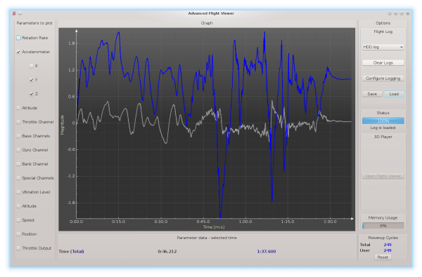

Example 3: Acceleration - [G] - Y (Aileron Axis), Z (Gravity)

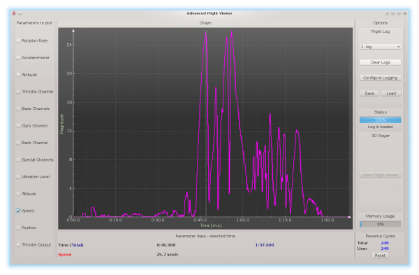

Example 4: Speed - [km/h] - Flight speed

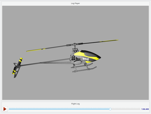

9 3D Player
From version 4.0.0 you can utilize 3D Player tool to visualize your model in 3D and replay whole flight. This feature is available also in Demo mode after loading backed up Flight logs.
Requirements:
  • Flight Log with Attitude recording enabled.
