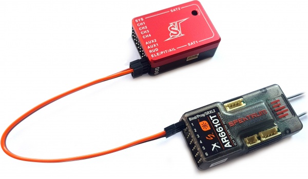

SRXL2 receiver JETI integration cable cable must be connected at BIND/DATA/SRXL2 port of the receiver. Spirit unit Other end of the JETI integration cable should be connected so that Orange wire is at the AIL pin. Powering plug with Red and Brown wires must be at the RUD port. (see the photo)

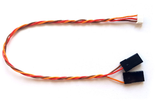

By using the SRXL2 adapter you will not need any additional modification to the satellite receiver. Cable is available in our E-Shop.
In case that your SRXL2 receiver is not bound yet, you can do so by pressing embedded Bind button. Press the Bind button at the receiver during power up..

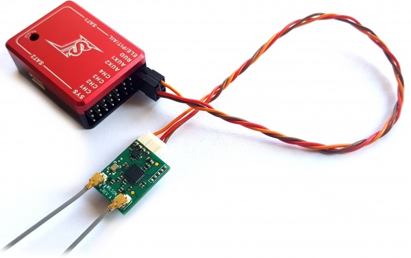

SRXL2 receiver SRXL2 adapter cable must be connected at the JST socket in receiver. Spirit unit Other end of the SRXL2 adapter should be connected so that Orange wire is at the AIL pin. Powering plug with Red and Brown wires must be at the RUD port. (see the photo)

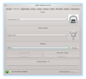

Now you are ready to power up the unit. If your Power supply is not connected yet, we recommend to connect it to the AUX1, AUX2 and/or CH0 port. Before you can utilize the Spektrum integration connection, it is important to set the SRXL2 receiver type in the General tab of the software. Please start the Spirit Settings and change the receiver type as displayed on the photo. Then save the settings (e.g. by CTRL+S) or the Backup tab/Unit - Save and restart the unit.
