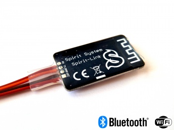

Spirit-Link is innovative module to allow wireless access to all Spirit units. It has support for BlueTooth and WiFi standard in the one, small form factor.
Module called Spirit-Link (BT) is preloaded with firmware for BlueTooth and can be used as a classic BlueTooth module. It replaced completely older Spirit BlueTooth modules. Since module can be updated Over The Air it can act as Wifi-Link in the future.
