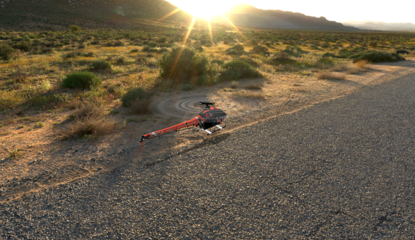

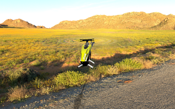

3 ScreenShots and Videos
YouTube video: [1]
