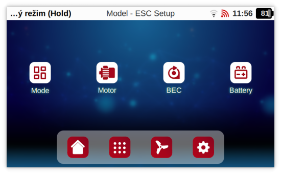

For accessing ESC parameters you have to enter Model - ESC - ESC Setup page. This page is available only if ESC Integration is really working. This mean ESC Setup might not work because of:
  • Wrong Wiring
  • Wrong (old) ESC firmware
  • Wrong telemetry protocol configured in the ESC.
If you can see no ESC telemetry values then this integration will not work.

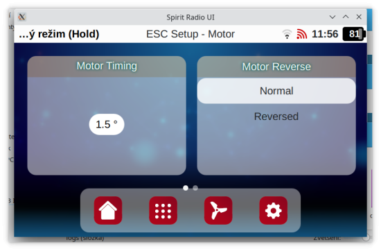

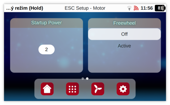

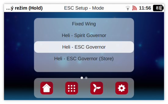

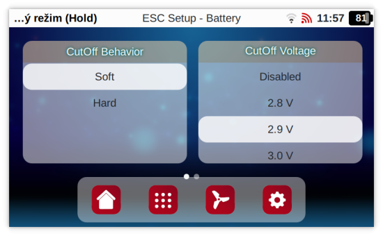

4.1 ESC Setup
Parameters can be easily accessed as part of the Wave User Interface without requirement of installing any special tool.
Following screenshots were recorded from HobbyWing v5 configuration interface.
