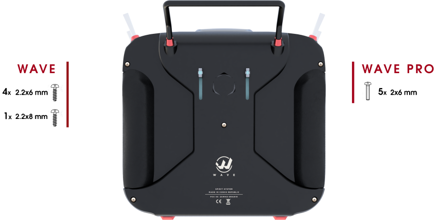

1.1.1 Back Cover
Use supplied Torx T6 Key to open the Wave radio. Unscrew 5 screws in Total.
Warning.png Plastic Body of the Wave radio has center screw longer! When assembling the chasis make sure to insert it only at this center opening.

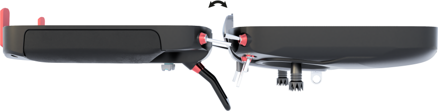

1.1.2 Two Chasis parts
When all 5 screws were disassembled continue in the following way. Gently move top and bottom parts apart.
1.1.3 Opened
As the last step, put front sides carefully near each other. Both parts are interconnected. To maintain connection of all the cables, proceed with the following photo.
