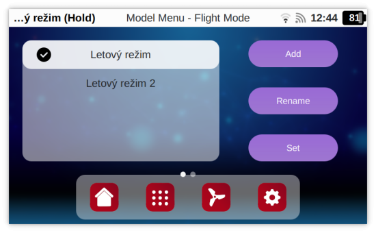

3.1 Flight Modes

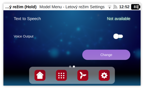

Voice Output can be configured for each Flight Mode. The output, if enabled, is triggered immediately when Flight Mode is changed and become active.
Go to Model - Flight Mode page. Then select Flight Mode for which you wish to set Voice Output and press Set Button. Lastly go to Second page that is dedicated to Voice Output.
  • Bear in mind this settings will not affect other Flight Modes.
  • Each Flight Mode can be configured differently.
  • Each Flight Mode can have Voice Output enabled or disabled.
Text To Speech displays text that will be be said. When you can see Not Available it mean you have to set new Text by pressing at the Change button. Then any word or sentence is automatically synthetized and in a blink of eye ready. You can change the Text as needed.
If you need to configure Voice Output for Each Flight mode, it is required to go one page back, select other Flight Mode and set it similarly there.

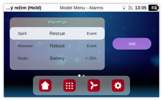

4 Alarms
Alarms can set the rest of Voice Output Types. To distinguish Alarm Type well there are two Alarm Groups:
  • Warnings - This Group can contain all Alarms that are triggered when a configured Condition is met.
  • Reporting - This Group can contain all Alarms where a Value has to be Reported at a Periodic Rate.

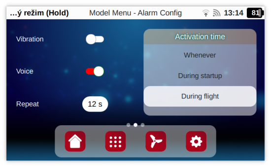

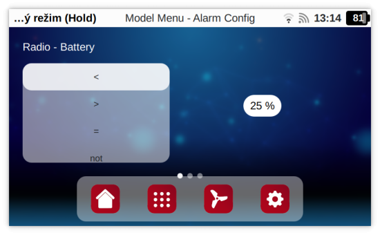

4.1 Warnings
Warnings are mainly used for Voice Output but can also notify pilot without Voice - you can choose to enable only vibrations.
Wave-voice-warnings.png Wave-voice-warnings2.png Wave-voice-warnings3.png Wave-voice-warnings4.png
Options:
  • Condition - Value is Less then (<), Value is Greater than (>), Value is Equal to (=), Value is not Equal to (not).
  • Value - Alarm Value used for condition checking.
  • Vibration - When Alarm is triggered Vibrations are used as Notification.
  • Voice - When Alarm is triggered Voice Output is used as Notification.
  • Repeat - This will repeat same Alarm (Voice Output and/or Vibration) in case that condition is still met.
  • Activation Time - During startup mean immediately after Radio Bootup or as soon as connection with Model is established.
Certain Alarms can't be set for Value comparison and are behaving only as Event notification. In this case there is Event displayed instead of Conditions.

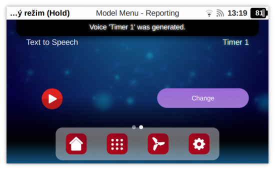

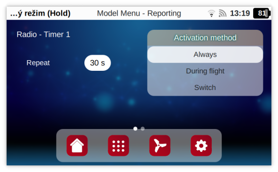

4.2 Reporting
Wave-voice-reporting.png Wave-voice-reporting2.png Wave-voice-reporting3.png
When Pilot need to hear a Value in a periodic manner it is possible to set Reporting Alarm. Telemetry variables are great example for this. For example it is possible to Call Out Battery Capacity periodically to find out if it is good time for landing. Or to call out remaining Flight Time based on System Timer.
Options:
  • Repeat - This will repeat Voice Output with a fresh Value based on selected Variable.
  • Activation Time - During startup mean immediately after Radio Bootup or as soon as connection with Model is established. Switch option can be used for enabling Call Out only when selected Input is in Active position. For example in a certain Switch position you can start to hear current Head Spead periodically. This can be configured to any Switch or Input and any Position as per user requirements.

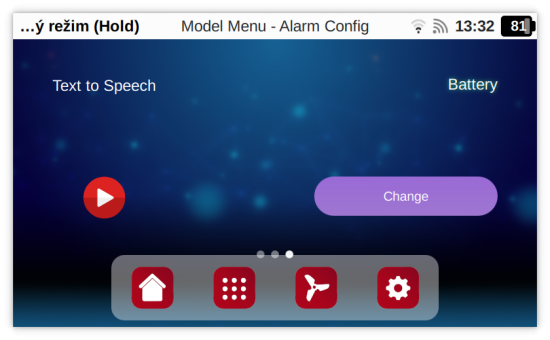

4.2.1 Custom Voices
Special type of Reporting Alarm is called User. This can be set to Call Out any Text based only on configured Wave Radio Input. This is great for programming your Custom Voices with a Special Purpose such as Landing Gear condition, Stabilisation Modes or similar.
