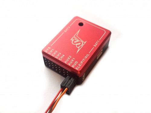

Spirit unit Other end of the JETI integration cable should be connected so that Orange wire is at the AIL pin. Powering plug with Red and Brown wires must be at the RUD port. (see the photo)

Spirit unit Other end of the SRXL2 adapter should be connected so that Orange wire is at the AIL pin. Powering plug with Red and Brown wires must be at the RUD port. (see the photo)
