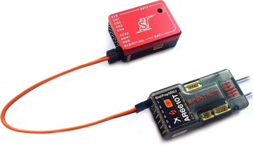

1.1 Spektrum AR6610T
By using the Jeti integration cable you will not need any additional modification to the receiver. Cable is available in our E-Shop.
Info.png In case that your SRXL2 receiver is not bound yet, you can do so by pressing embedded Bind button. Press the Bind button at the receiver during power up..
SRXL2 receiver JETI integration cable cable must be connected at BIND/DATA/SRXL2 port of the receiver.
Spirit unit Other end of the JETI integration cable should be connected so that Orange wire is at the AIL pin. Powering plug with Red and Brown wires must be at the RUD port. (see the photo)
Spektrum AR6610T SRXL2 receiver
