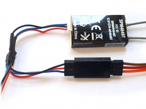

  • At the receiver side (SPM4649T) the Jeti integraction cable must be connected to the Servo socket. This socket is used also for Binding.
  • Then connect the Jeti integration cable to the unit so that red and brown wires are connected to the RUD port.
  • Orange wire should be connected with the AIL pin.
