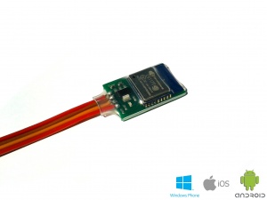

1 FEATURES
Power supply: 3.3V - 15V
Weight: 7g
Dimension: 21x32x5.5mm
Operating range: up to 50 meters
Modes: AP, AP+Client, Client
Standard: 802.11b/g/n
Encryption: Open, WEP, WPA, WPA2
Configuration: Web Interface
Power consumption: 80 – 350mA
Supported devices:
  • Android (available on the Google Play)
  • All smartphones, tablets, smart TV with Web Browser
  • PC
  • Mac
Support for Firmware Updates.
Web based Spirit Settings app in the module!
2 CONNECTION
Wire Meaning
VCC Positive powering lead: 3.3V – 15V
GND Ground powering lead
RX Communication lead; SYS port
TX Communication lead; SYS port
NOTE
TX wire must be always closer to the SYS label. RX wire must be always in the center pin of the SYS port.
VCC and GND can be connected to any port, except ELE/PIT/AIL and SYS. It can be connected to a receiver port too. If powered from a separate battery, GND must be connected with the unit's power source.
Do not connect communication cable to the power supply! It can be connected only to the SYS port.
