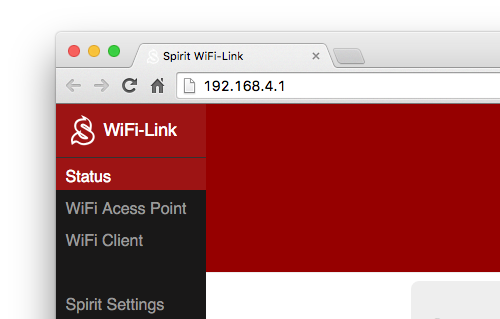

  3. Enter the module with this address: http://192.168.4.1
    By entering „192.168.4.1“ you will get into the configuration.Here you can change any parameter including changing SSID,password or wireless mode.

4.1 Web Browser - iOS, WP, Sailfish OS, PC, Mac, ...
  1. Go to Settings/Wi-Fi in Operating System, search for a new networks.
  2. Connect to the „Spirit Wifi-Link ...“ network.
  4. Click the Spirit Settings in the Menu of the Wifi-Link interface
