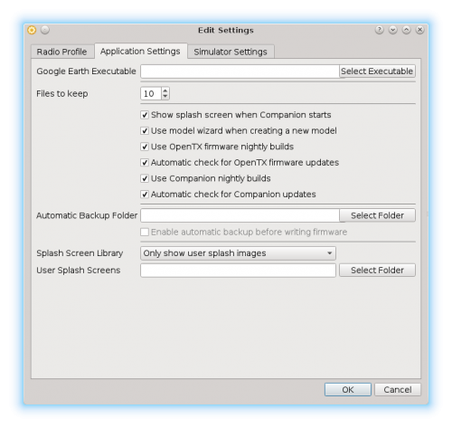

3 Nightly Builds
Install the Companion software as you are used to do now. Start the software and open the Settings/Settings menu.
Tick Use OpenTX firmware nightly nuilds option.
Then confirm the settings and restart the software.
After the restart you will see the Popup window with notification about the new firmware. Click Yes to download and save the firmware to your computer.
