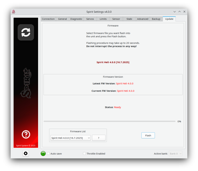

  3. Go to the Update tab. If you can't see Update tab, please enlarge the app window or press F10.
  4. You can select which firmware should be downloaded from the Firmware List. By default the latest one is selected.
  5. Press the Flash button.
  6. Flashing should start immediately and should not take more than one minute.
  7. After flashing you can wait until unit will boot up, close the software and open it again.
