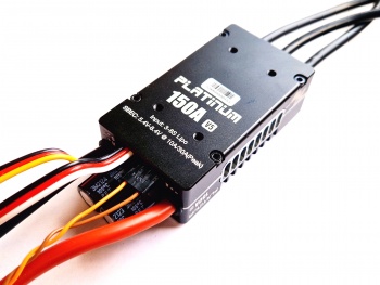

HobbyWing Platinum V5 ESC has telemetry feature built-in in the Programming port. This allows telemetry data transmission to the unit.
1 Telemetry Cable
To allow the telemetry data transmission the Telem UNI cable is required. This cable is available in our Eshop.
Warning.png We do not recommend to make this cable at home since improper connection will cause permanent damage of the unit. The Red wire must be internally disconnected always!

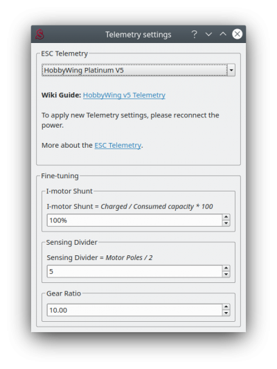

Power up the ESC and start the Spirit Settings as usually.
3.1 Telemetry activation
As the last step you have to set the ESC Telemetry in the Spirit Settings software.
Go to the Advanced/Telemetry settings and set the HobbyWing Platinum V5 option.
If using Spirit Wave you can do the same settings at Model - ESC - Type page.
Then close the window and save the settings (CTRL+S). Finally, reconnect battery from the ESC.
From this moment, everything should work.
