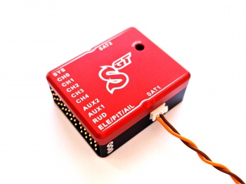

Connect the Telemetry cable to the primary Spektrum satellite port (SAT1) in the unit - apply for Spirit 2, Spirit 3, Spirit RS, Spirit Pro, Spirit GT, Spirit GTR, Spirit W1.
There is no support for Spirit v1 units.
Servo connector of the Telem OMP cable should be connected to the ESC - programming port. Make sure to connect Orange wire of the Telem OMP cable at the TX pin. Brown pin at the - pin.
