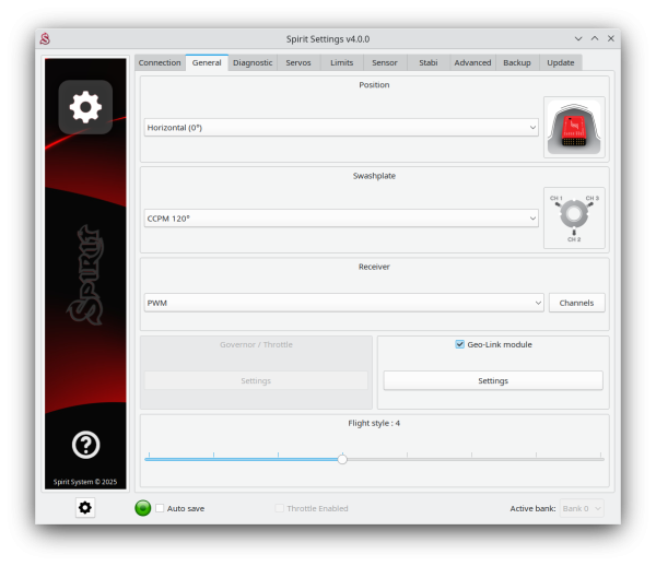

5.2 GENERAL
If you have already set up the unit using the wizard, you can make additional adjustments to your setup here. All values relate to the settings you selected in the wizard.
Info.png Whenever parameters are changed, the new value is immediately applied but not saved. Unless settings are manually saved, after disconnecting the power supply all unsaved changes will be lost. (see Backup tab.)
Position
Selects the position in which the unit is attached to the model. (See section 3 - Installation)
Swashplate
Select the swash type of your model. In most cases it is CCPM 120° or CCPM 120° (reversed).
Warning.png Any swash mixing in the transmitter must be turned off. It must be configured to H1 (single servo) type.
Receiver
Select the type of receiver you are using:
  • PWM – standard receiver.
  • PPM – single line connection.
  • Spektrum DSM2/DSMX – DSM2 or DSMX satellite or SPM4649T receiver. (for Spektrum integration).
  • Futaba S-BUS – receiver connected via SBUS. (for Futaba telemetry)
  • Jeti EX Bus – receiver connected via EX Bus (for JETI model integration).
  • SRXL/SUMD – receiver connected via SRXL, SUMD, UDI (for HoTT integration).
  • Spektrum SRXL2 – receiver connected via SRXL2 (more details at Spektrum SRXL2).
  • FrSky F.Port – receiver connected via F.Port (more details at FrSky F.Port).
  • FrSky F.BUS – receiver connected via FBUS protocol (more details at FrSky FBUS).
  • JR XBUS A – receiver connected via XBUS mode A (more details at JR XBUS mode A).
  • Spirit RX – receiver connected via Spirit Wave protocol (more details at Spirit RX).
Flight style
Sets how the model will behave in flight. This parameter is used to control and adapt flight behavior according to the requirements of the pilot. It has significant impact on a pirouetting maneuvers (cyclic steering), but not pirouettes (rudder) itself. Parameter has no impact on a stability. Generally, for bigger models higher value is recommended.
Lower values mean that the model will behave in a more consistent, controlled manner and will feel more linear and robotic. It could introduce a delay to the steering. Angular momentum will be held more constantly.
Higher values mean a more natural behavior. The response to stick movements will be more flybar-like where fast movement will introduce agressive response. But a small movements near the center will be more precise. It can help to make tic-tocs faster. End of each cyclic input will become faster.
Recommended value for the most pilots: 4.
Channels
After clicking the button, the window with channel assignment is displayed. You can assign any channel to any function here. The number of available channels is dependent on the receiver type. Remember to only assign one channel to each function.
When a channel for Throttle function is assigned, throttle output from the unit can be obtained from the AUX position. When a channel for Bank function is assigned, then Bank switching is activated (See chapter 5.6).
When a channel for Gyro Gain function is unassigned, it is possible to configure gyro gain directly through this software in Sensor tab. The unassigned channel could be used in another way, e.g. for Bank switching.

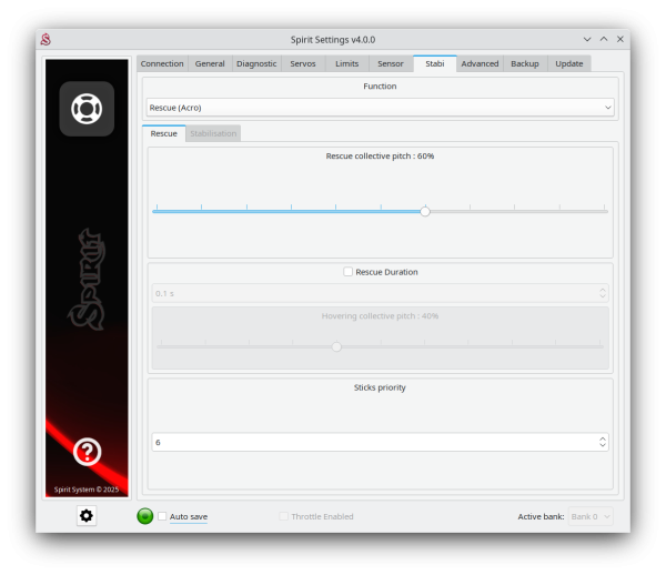

5.7 STABI TAB
The Spirit unit offers you the options of model stabilization and rescue mode.The stabilization function, once activated, will recover the model to a horizontal position without any other input from the pilot, this can be used as a “bail-out” feature when trying new maneuvers and can help with the learning process.
Rescue mode complements the normal operation of the Spirit unit. If activated, the model will recover to a horizontal position and add collective pitch as per the settings. This function can be used any time when the pilot loses orientation or control of the model.
As soon as pilot will disengage the rescue mode full control is regained immediately.
Stabilisation mode will maintain horizontal position of the model once sticks are released. Making flying very easy. Different behavior is available within our stabilisation modes. Collective pitch steering is unaffected with stabilisation.
How to setup the Rescue or Stabilisation is described in the Stabi mode page. There is also Setup Wizard for the Rescue available directly in the Spirit Settings. See Stabi tab when Function is set to Disabled.
You can activate selected Function by two different methods:
  • Negative Gyro Gain
  • Dedicated Channel
Negative Gyro Gain method is suitable for radios with low channel count (6 - 7). When you have available unused channel, method with a Dedicated channel is better and easier.
Currently selected mode is displayed in the Diagnostic tab.
Function
Here is where you select which mode should be activated at negative gyro gains.
  • Rescue (Normal) - Recovers the model to an upright horizontal position – skids always to the ground. This recovery mode is great for beginners.
  • Rescue (Acro) - Recovers the model to a horizontal position, inverted or upright, whichever is closer at the time of activation. For intermediatte and advanced pilots that are flying acrobatic maneuvers.
  • Stabilization (Normal) - stabilization mode - skids always to the ground. This mode is good for learning the basics such as hovering and slow transitions. Model is always pushed to the horizontal position.
  • Stabilization (Acro) - stabilization mode - inverted or upright, whichever is closer at the time of activation. This mode is used for learning the basics of acrobatic maneuvers. If the sticks are in the center, the model has tendency for returning to the horizontal position.
  • Stabilization (Scale) - stabilization mode - skids always to the ground. This mode is used for a scale flying. Gyro mode is Normal (Rate).
  • Coaxial - stabilization mode - inverted or upright, whichever is closer at the time of activation. The steering behavior is very similar to a coaxial helicopters. Great for learning a hovering practices.
  • Rescue (Automatic) - Recovers the model to an upright horizontal position – skids always to the ground – whenever is model under defined Hard Deck altitude. Rescue must be activated when flying but upon reaching low altitude it will take control of the model automatically. During lift off and landing it must be turned off. This recovery mode is great for beginners.
Warning.png Rescue, stabilisation and GeoLink features can be affected by condition of the model. Before testing it in flight please see this page.
Warning.png The rescue mode is very demanding for the BEC. Be sure your BEC can handle such peak loads. In case it is is not sufficient your model could crash! Never exceed angles recommended by manufacturer of the model, else the mechanics can be damaged during the flight!
Rescue collective pitch
This determines how fast the model will ascend during the rescue mode. 100% means the maximum deflection of the blades, which was configured in the Servos tab. It is very important to check whether the rescue mode works correctly before the first flight (on the bench without the motor/rotors running). Collective pitch should be always positive with the rescue engaged - while helicopter is on the ground
Sticks priority
Specifies the amount of control while configured mode is activated. The higher the value, the more the model will react to stick movements.
Direction control rate
This specifies the rate of controlling direction for the stabilization mode. Low values are well suited for beginners to get coaxial like behavior. Higher values are more appropriate for scale flying.
Acro Delay
Specifies a time period for the Rescue (Normal), when the model is recovered from the inverted flight. Until the period is reached, the rescue has the same behavior as the Rescue (Acro). In this way, faster ascending to a safe level can be achieved.
Rescue Duration
Once specified duration period will pass the Rescue mode will end and model will start to hover. For this purpose Hovering Collective Pitch value is used. The period is counted from time the Rescue mode was engaged. The parameter is available for both Rescue (Normal) and Rescue (Acro). Transition from Rescue to Hovering is smooth and will happen only if Rescue mode is still engaged. Collective Pitch control is returned to the pilot as soon as a pitch stick movement is recognized.
If Rescue Duration parameter is enabled and it will pass once Rescue mode was engaged the model will start to hover. To make the model hover it is necessary to set this parameter. If too low the model will be descending instead of hovering. If too high the model will be ascending instead of hovering. Value around 40% is recommended for hovering.

Stabi/Rescue Algorithm
Algorithm that can make Stabilisation, Rescue and GeoLink modes more precise.
  • Standard option for the most helicopters - Recommended.
  • High Precision for models with low vibrations - Electric models with smooth mechanics.
  • High Immunity for models with high vibrations - Combustion models.
Rescue - Smoothing factor
To reduce demand for model mechanics please increase the value. It will make a slower movements to reduce current spike and possible overload of the BEC/battery. This will increase safety of the Rescue maneuver, however too high value will result in a slower recovery.

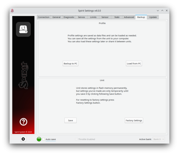

5.9 BACKUP TAB
Here, you can save the settings to your Spirit unit before powering off, you can also save the settings to your computer here, Should you need to reload them at a later date.
Profile
This section allows you to Save and Load complete settings of the unit to a specified file. If you have more than one of the same model, it is not necessary to carry out a complete setup again, just load the stored settings easily with the Load button.
Unit
Any changes to the configuration can be saved at any time to the internal flash memory of the unit. To put all settings to a factory defaults, click Factory Settings.
Info.png Remember to save the settings each time you want to store the settings permanently. You must press the Save button. Otherwise, the changes will be lost after the Spirit FBL unit is turned off.
Bank Switching
In case that the Bank Switching is enabled, you can save the settings from single bank or even all banks. To see the differences between Banks you can use Bank Comparison feature.
